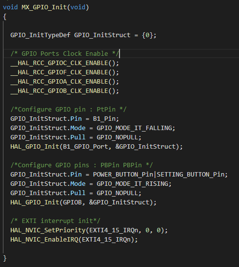

I've managed to get UART (just direct calls, not interrupt based), PWM, and ADC working on a Nucleo board (namely, the STM32F070RB board). However, I'm having serious trouble getting a simple push-button to fire an interrupt.
I'm using the on-board user button, tied to C13. I know this works and is not a hardware/solder bridge problem, because I've probed the exposed pin and it certainly changes between 3.3V/0V when released/pressed.
I watched this tutorial video and it seemed simple enough (like most things, thanks to STM32Cube): https://www.youtube.com/watch?v=UtkszckecV8
Sadly, I've had no luck. Here's a look at some of my code.
gpio.c generated from STM32Cube:

Sorry. It was actually a problem with my programmer/ELF file. It turned out for some reason the new compiled hex/bin (which had the interrupt implemented) wasn't getting flashed, and so things weren't working before. The code I have posted does in fact work.
