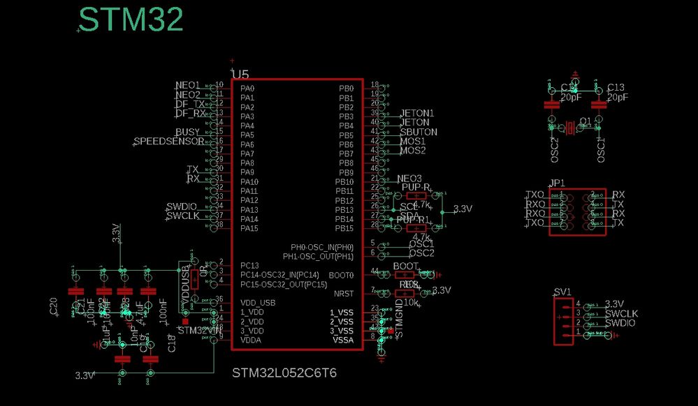

I am using stm32f072c8t6 in my project but stlink does not connect stm32 somehow
How can I detect the fault?
boot pin > 10k > GND
NRST pin>10k 3.3v

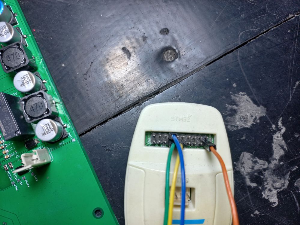

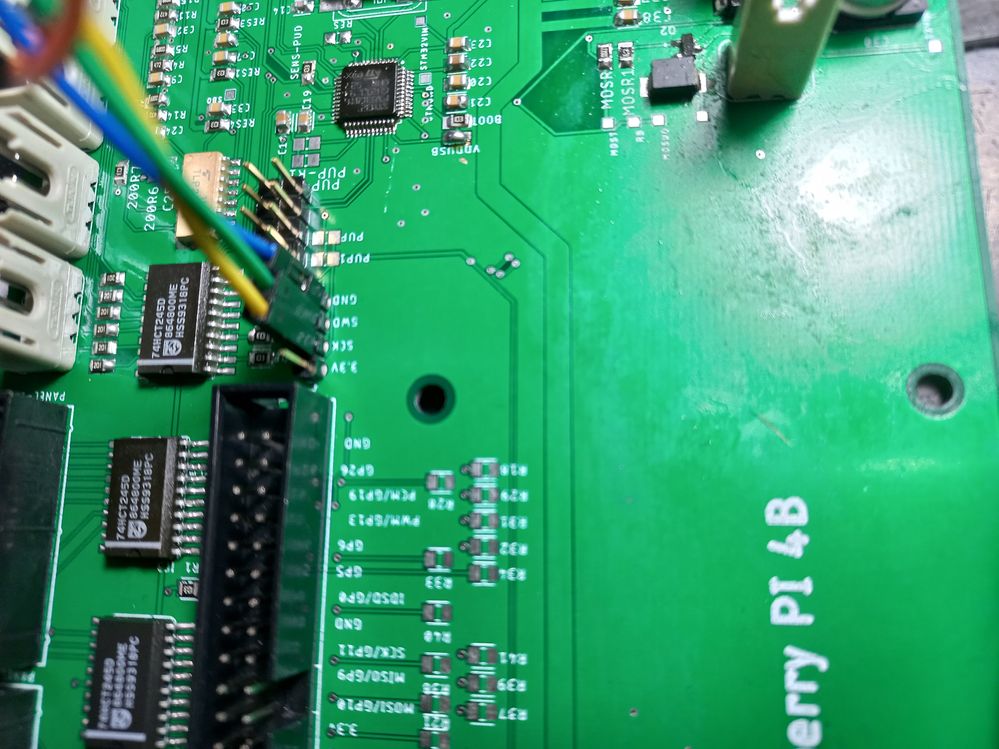

Show a picture of board with ST-LINK attached to it.
Schematic looks Ok, check the voltages on the board.
2021-09-01 7:26 PM
2021-09-01 7:43 PM
Need to connect the 3.3V pin to Pin 1 on the ST-LINK 20-pin connector (bottom left as pictured)
2021-09-01 7:50 PM
that cable was connected normally and it came out while taking pictures.
bidet gives internal command error in keilde debug section
