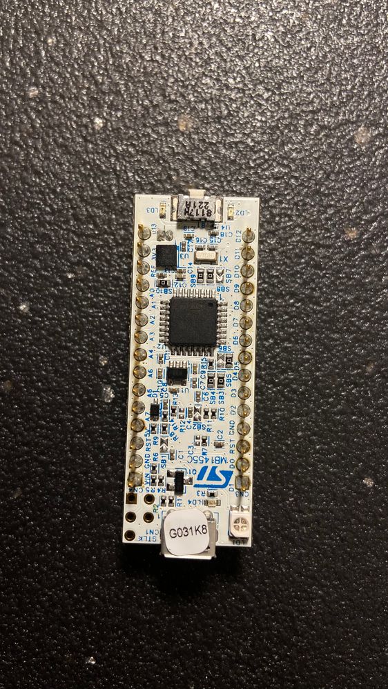

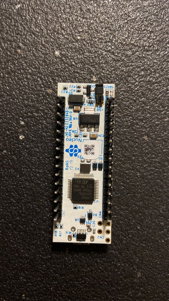

Are you sure the NRST solder bridge isn't made.
Take a clear photo of front/rear of board as you have it now.
High Resolution, In Focus

2021-09-01 7:05 PM
2021-09-01 7:17 PM
My apologies I’m relatively new to the STM32 ecosystem here. Do you mean connect pc via USB to use the onboard ST-LINK debugger or connect my dedicated ST-Link dongle? Im not sure how to do that with the SWD pins not exposed on this board. Forgive me if I’m confused here. Seems like the STM32 mcu has a pretty steep learning curve.
