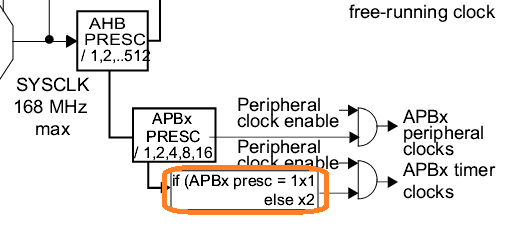

That would suggest you are using an APB2 timer clocking at 168 MHz. APB2 might be at DIV2 (84 MHz), but TIMCLK will be at DIV1 (168 MHz). See Clock Tree

@Clive - Well, it took me a little while for what you wrote to click. Yes I now understand and so far all testing is working.
168000000 / 840 = 200000
200000 = 20 * 10000
this.Period = (10000 - 1);
this.Prescalar = (20 - 1); this.Duration = (10000 / 2);Output Frequency: 840Hz

So, simple you were right, my in-experience did over look this Clock issue by the looks of it. Some confusion entered the picture: 168000000 / 2 = 84000000 - I real all over the web that APB2 was 84000000 and it is but the calculation you gave is not for the divider product, its for the Clock for APB2. 84000000 is only CK_CNT, not the APB2 Bus Speed: clock frequency = 168000000.Factoring:

The TIMCLK is typically twice the APB clock, it's often useful for timers to clock as fast as possible.
On the F4 running at 168 MHz, APB1 is typically 42 MHz (DIV4) and APB2 84 MHz (DIV2), and the respective TIMCLKs are 84 MHz, and 168 MHz. The APB2 timers are ALL 16-bit, presumably due to the cost of clocking a 32-bit counter at 168 MHz2014-10-05 2:49 PM
