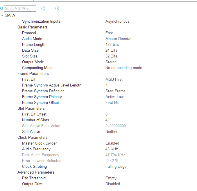

Hi, Im trying to connect adau1772 using TDM-4 Protocol to an STM32 MCU (L462RE).
Question 1: How to configure SAI as TDM-4, is my configuration wrong?
Question 2: Correct callback which occures when data packed is received?
Question 3: adau1772 is putting 24bit per channel, so 24*4 is 96bit per frame, How do I set 96 as frame length for SAI?

Thank you, I found out that my configuration was wrong. but what about Q2 (Question 2: Correct callback which occures when data packed is received?)?
Also Is that a problem that real audio freq is not exactly 48kHz?
In case someone need TDM-4 configuration for adau1772 I'm attaching picture of my new config.
That was because you've not read the codec's datasheet. Chapter "SERIAL DATA INPUT/OUTPUT PORTS" describes supported protocols pretty clearly.
What's the problem with looking at the respective API functions and reading more about those in *.c file or HAL documentation?
No.
