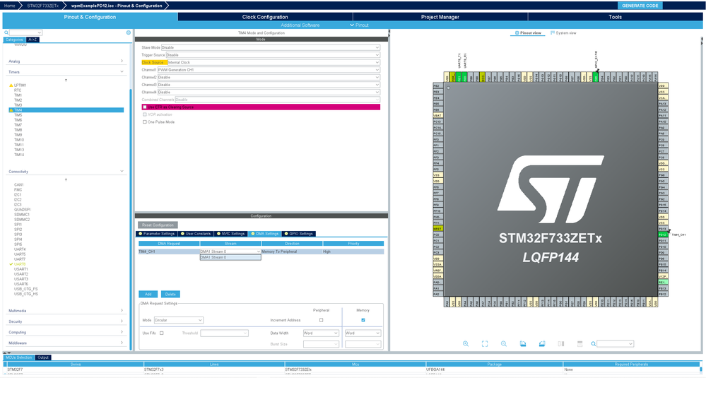

Hi I dont have the option to set to DMA1 stream 2:

Hi I have change to using DMA1 stream 6, but still face the same issue where the DMA seems pretty "random".

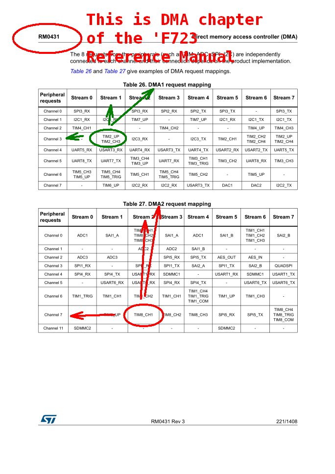

Hi thanks for the reply, another question, in which document is it written TIM4 UDE is bound to DMA1 stream 6 ?, If I were to change to TIM2_CH3 and TIM8_CH1, what are the respective DMA stream ?
2020-06-29 10:37 PM
2020-07-01 12:16 AM
