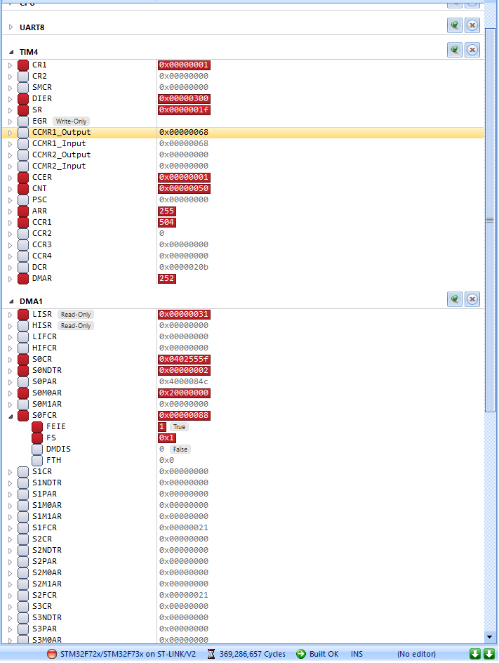

Thanks for the reply, I tried the TIM DMA, and got the DMA and TIM register to the following settings, however it seems that no interrupt is happening, I don't see the ARR change. Can you help me check if my settings are correct ?
2020-06-24 5:24 AM
Okay, from the screenshots we can guess it's 'F723. You should've told us.
DMA1 Stream 0 (set to Channel 2) is triggered by TIM4_CH1, you should've set TIM4_DIER.CC1DE for that.
Then that should work, but IMO it's better to leave the trigger from update (DIER.UDE=1 as it is now), and use the respective DMA1 Stream 6 (at channel 2).

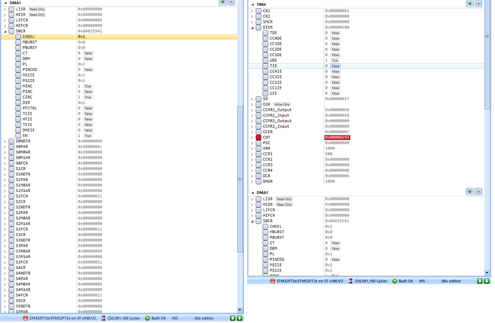

Hi thanks for the reply ! I have got the interrupt now and the DMA is running, however I encounter something very strange.

why is this so strange ? It says in the document if I set DCR to 0x20B, it should DMA 3 element in the array each time the DMA is triggered, why the pattern seems so "random".
here is my register set:
2020-06-24 7:59 PM
I don't understand what are you trying to do, but don't use both the CC1DE and UDE - use only UDE and change the DMA stream as I wrote above.
