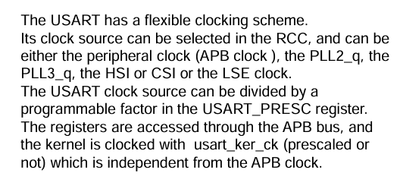

2024-07-05 1:42 AM
You can find it in the document in ST website which name is "STM32H7-Peripheral-USART interface (USART)". Write it google you will find this document. I attached the photo of the part where I solved my own problem.
2024-07-05 2:46 AM - edited 2024-07-05 2:55 AM
Missing HSE in the documentation doesn't mean that HSE should not be used. So how did you select HSE for the USARt if you are using CubeMx? that doesn't make sense. The USART should not select HSE for it. So in that case how did you use HSE as clock source for USART?
For example the UART examples on the STM32H743I-EVAL board use HSE as source clock. So your issue is something else. You need to share your project.
