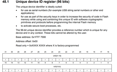

I referred the RM0440,As below image they mentioned base address 0x1FFF7590.Is that the address of UID number stored memory.
If so, that address is not stored in flash/system memory/OTP/option bytes but it is factory programmed memory.
Can you please provide the resources to read the UID number from MCU.
As soon as you truncate it, a unique serial number is no longer given.
I am not planning to reduce the UID number If I use that UID,I will use full 96-bit number then can I use that number for serial number?

2024-04-03 2:41 AM
Correct, 0x1FFF7590 is the base address (named UID_BASE in the firmware) of the UID.
It is also correct that the UID is factory programmed and cannot be changed.
The UID can be determined simply by reading the three 32-bit values UID_BASE, UID_BASE+4 and UID_BASE+8. You can also use the HAL or LL library to do this:
stm32g4xx_hal.c:
uint32_t HAL_GetUIDw0(void)
uint32_t HAL_GetUIDw1(void)
uint32_t HAL_GetUIDw2(void)
stm32g4xx_ll_utils.h:
uint32_t LL_GetUID_Word0(void)
uint32_t LL_GetUID_Word1(void)
uint32_t LL_GetUID_Word2(void)
Of course you can use this UID as a unique serial number.
