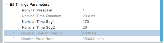

Your seg2 is almost the same as seg1. So your sampling point is almost in the middle. You want to sample close to 87% give or take
If the FDCAN clock is 50MHz, then try these values

If you are using HSE for the FDCAN, do you actually have an external oscillator? If so, what frequency?
2025-05-30 12:27 PM - edited 2025-05-30 12:28 PM
Assuming you have an external clock at 12MHz, try the attached IOC changed to use 66MHz and use the values below. I have values for 12MHz as well
| Baud 250000 bit/s | |||
| FDCAN clock freq(kHz) | seg1 | seg2 | prescaler |
| 12000 | 39 | 8 | 1 |
| 66000 | 219 | 44 | 1 |
