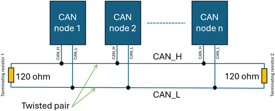

I checked and all nodes had 120 ohms resistors. So I removed the one at the end of the CAN bus and the one from the USB-CAN. This leaves the one from the BMS and the CAN transceiver.
2025-05-30 8:25 AM - edited 2025-05-30 8:43 AM
2025-05-30 8:35 AM
You need only two terminating resistors at both sides of the bus:
If you are using HSI please switch to a HSE/crystal to feed FDCAN clock.
