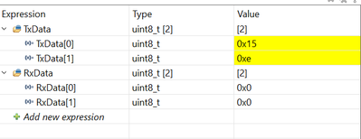

I modified your project (in attachement) to work in RX FIFO interrupt mode. SystemClock at 48MHz / CAN bitrate at 500kb/s (modified the prescaler, BS1 and BS2 with recommended values).
Unfortunately I don't have a board to test that MCU part number. So you need to test it from your side: in the Live Expression check RxData[].
Hope it helps.

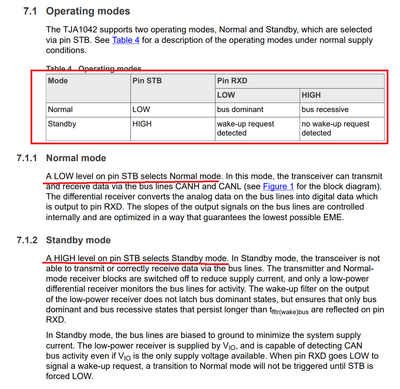

The circuit on CAN_STBY is putting the TJA1042BT probably in standby. The STB pin is a digital input, so setting it to 1.6V is definitively not a good idea. Please remove R5 to enable the Driver.
Martin
2024-09-11 7:59 AM
Martin
Yes it could be related to this.
2024-09-11 10:42 PM
I tried the interrupt code you have provided. But there is no change. Nothing is receiving as RxData.

Thank You all for reply.
The issue was related to the standby pin on the transceiver. I started receiving data once the STBY pin was set to low.
