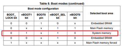

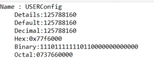

The issue is, since nBOOT_SEL is set to '1' by default I need to change it to 0 so I go in bootloader if my pin PA14-BOOT0 is tied up at startup. I find how to change it in STM32CubeProgrammer but I would like to do it in my firmware so the flashing process is not too complicated in factory.

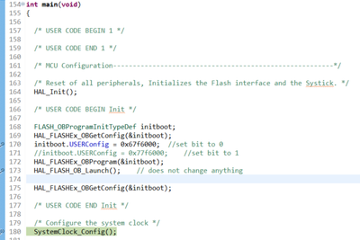

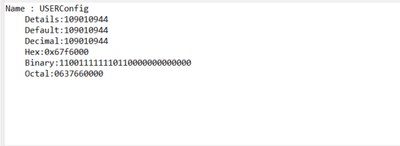

I've tried this but it does not have any effect :

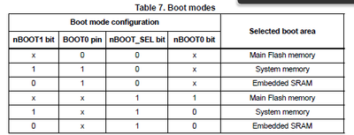

Hello
I know this table, as I said I've been able de modify "nBOOT_SEL" bit in the STM32CubeProgrammer but I would like to implement it in my firmware. So they only need to flash a firmware in factory.

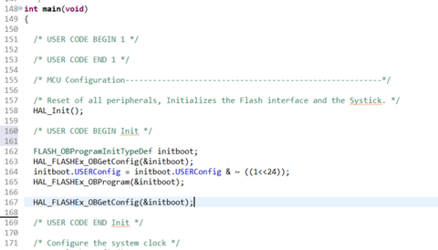

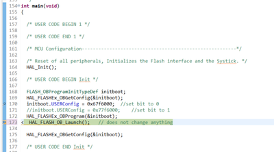

I am developping on STM32CubeIDE v1.16.0, I tried to use the function "HAL_FLASHEx_OBGetConfig". Can you tell me if I am using this function wrong or I have to do an other way ?

D you mean you cannot change your "nBOOT_SEL" bit from 1 to 0 by the function HAL_FLASHEx_OBProgram?
please note:
New option bytes configuration will be taken into account in two cases:
* - after an option bytes launch through the call of @ref HAL_FLASH_OB_Launch()
* - after a power reset (BOR reset or exit from Standby/Shutdown modes)

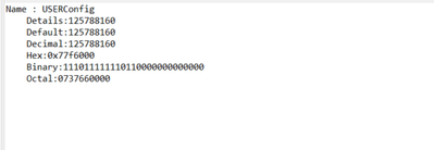

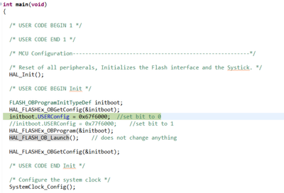

I've tried to add HAL_FLASH_OB_Launch() :
I didi'nt tried power reset because when I do programm then get it seems like the modification didn't do anything in the register and it changed only my local structure.
