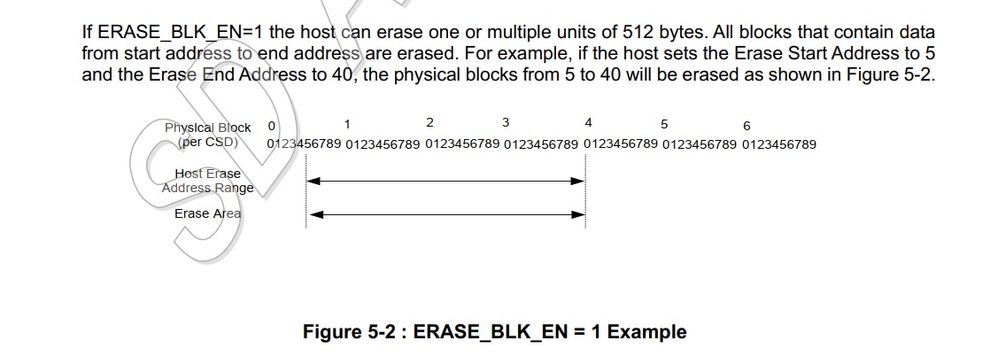

2020-10-19 9:52 AM
Thank you , And I'm not using FatFs ,At this time I just am using this library nothing else .
And in picture below there is an example of "Physical_Layer_Simplified_Specification"
So,Still here have this question not answered :
I knew different between SDSC byte address oriented card and SDHC-SDXC block address .
The problem is with those two function maybe with an example it will be better explanation .
Imagine flag_SDHC = 1 ; -> so the card is block address type .
Now we will call SD_SendCmd function :
1- For start erase address it would be like this :
//The Second parameter will replace with 1 because we want to erase from first or block number one and because "lag_SDHC = 1" so because of ternary operator "?" block number 1 * 1 will be 1 :
SD_SendCmd(SD_CMD_SD_ERASE_GRP_START, 1 , 0xFF, SD_ANSWER_R1_EXPECTED);which has no problem and everything seems fine .
2- For end erase address it would be like this :
//The Second parameter will replace with 5( as an example we want block number 5 will be our end erase address ) and because of "flag_SDHC = 1" and because of ternary operator "?" resault for second function parameter will be (5 * 512)*(1) which is block 2560 !!! :
SD_SendCmd(SD_CMD_SD_ERASE_GRP_END, (5*512) * (1), 0xFF, SD_ANSWER_R1_EXPECTED);But here is the problem it will multiply our EndAddress with 512 ! why should we do this ? why like start address it is not just block number as in last picture sd specification example said (without any multiplication to 512) ?
For CSD v2 in sector_size it has said it is not related to erase operation and AU size has affect on this ? Isn't it related to this 512 ?
