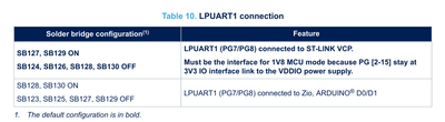

Where are you measuring the pin? They're not connected to headers by default.
Doe TXE/TC flags get set and cleared as expected?
2025-06-27 2:20 PM
I attach an image showing my setup. To my understanding, even though the pins are connected to the ST-LINK, I can still observe their values through the sockets? When I flash the board with Zephyr, I observe some activity on this pin using this setup every 500 ms when my program writes a character. The little wire is placed into the socket designated PG7.
I am unable to verify that the pins are correctly set right now (will have to wait until tomorrow), but my writing is done in a loop that also blinks an LED, and the LED blinks as expected. Clearly my program is not halting on one of my conditions. Perhaps my conditions are not correct?
Also, I now see that in the code I posted the actual writing of a character is commented out. Of course this is commented _in_ in the code that I am executing. I will try to edit my post.
