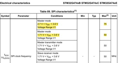

The max clock speed of some things will be lower at 1.8 V than at 3.3 V. For example, the max SPI speed is lower. You can see this in the datasheet.
However, the core clock can still run at 170 MHz at 1.8 V. No loss in performance there.
