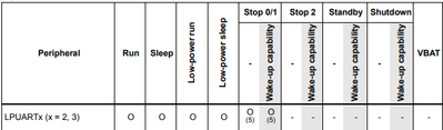

Based on the reference manual table 22
LPUART 2 and 3 does not support wakeup capability from stop 2 mode.
Only LPUART1 supports this feature. This limitation is intentional to make stop 2 mode more power efficient.
I recommend using LPUART1, or use stop 0 or stop 1 mode if you need to use LPUART2 or LPUART3.

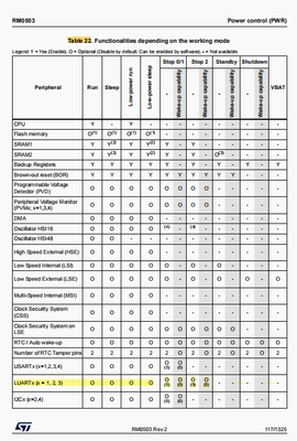

Hi @Gyessine ,
Thank you for the response. When we checked the reference manual, Table 22 indicates that LPUART (x = 1, 2, 3) supports wake-up from Stop 2 mode (I’ve attached a screenshot for reference). However, it appears that this information differs between document versions. The document you referred to is RM0503 Rev. 4, whereas we were referring to RM0503 Rev. 2.
I also reverified the ST example using LPUART2 with Stop 1 mode instead of Stop 2, and it works correctly.

Hello @Errorr__
the fact that LPUART2 and LPUART3 supports wake-up capability in stop 2 mode in revision 2 is a documentation error that was corrected in newer versions
Always good to make sure you have the most recent revision!
If you look at the revision history in Rev 4, you'll see that a lot was changed since Rev 2.
