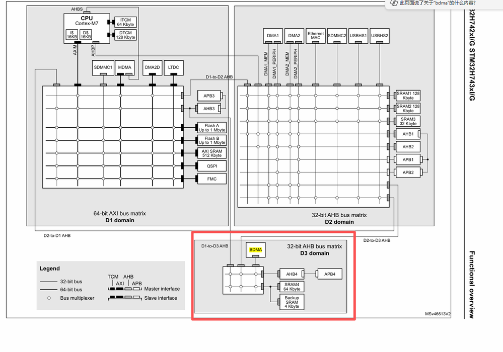

The chip I'm using is stm32H743vit. I've identified the issue. The DMA used by LPuart is BDMA. BDMA can only be directly connected to SRAM4. I can simply define the variables within SRAM4. Thank you very much.
