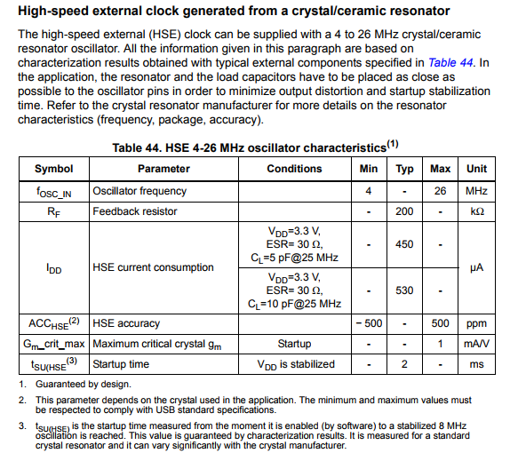

for the STM32F7. The only problem being is that I cant find a component that respects the recommended values found in the following arm . Even STM for it's STM32F779I-EVAL board does not respect the gain_margin.If I have understood correctly there is one main rule governing the choice for a crystal so that the oscillator starts and reaches a stable phase.
gainmargin = gm / gmcrit
gm is the oscillator transconductance specified in the STM32F779 datasheet.
gmcrit is computed from oscillation-loop passive components parameters.
The one used for the eval board is this one :
https://www.eltech.spb.ru/files/item/NX3225HA-STD-CRT-1.pdf
But I found gainmargin = 1.674730 when it's supposed to be >5
Does anyone know why?

I think I finally understood... it's in the datasheet but it really needs to be clarified.
As stated in the the design guide p 13:
http://www.st.com/resource/en/application_note/cd00221665.pdf
This is because the following conversion needs to be done before when considering the g_mcrit that was calculated (p14)
For example, with
http://www.st.com/resource/en/datasheet/stm32f100cb.pdf
First I multiple by 5 the
Gm_crit_max
5*Gm_crit_max =
g_m => 5 x 1mA/V = 5
Then I divide by gm_crit that I had calculated for my quartz
gm/gm_crit = gain_margin => 5 / 0.3 = 16
