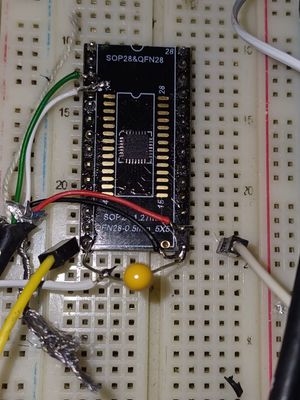

i have a stlink v3 mini and 3 stm32c031g4u6 microcontrollers soldered to proper breakout boards.
i have SWD interface soldered from the edge connector because i had no luck with cn4.
SWDIO, SWCLK and RESET are connected. i also have an led soldered to power pins to be sure its powered.
i am sure of the soldering job.
on my first post someone recommeded i solder capasitors so i did that still no result.
i am using linux mint's latest and the code i am trying to upload is just empty machine generated code

The VDD from the AM1117 needs to go to the CN2.10 / T_VCC pin on the ST-LINK-V3MINIE
STM32 Cube Programmer should be able to report the board voltage
The T_VCC is there to power the buffers between the ST-LINK and the Target MCU, say for systems running at 1.8V, 2.7V or whatever

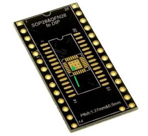

I just want to point out that the very first bullet in the very first reply to your previous thread was to check part orientation along with where pin 1 relative to the text, which you didn't check or at least didn't notice/fix until it was pointed out here.
Perhaps slow down. If you do things correctly, you only need to do them once.
2024-01-11 1:21 PM - edited 2024-01-11 1:55 PM
Wiring still looks wrong if the IC is still rotated 90 degrees or 7 pins
Draw a chart, probe continuity and confirm where pin 1 exits
Newer thoughts..
2024-01-11 1:23 PM
it reads 3,25 Volts. fixed the wiring still nothing.
any ideas on what am i doing wrong?

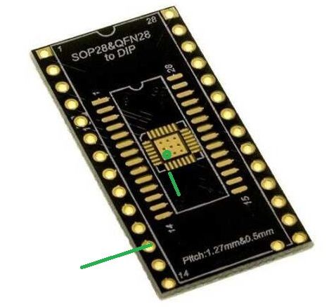

The adapter is quite confusing in it's pin numbering. I've marked Pin 1 on the STM32 you've placed
2024-01-11 2:03 PM
i am thankful for all the help. i have checked it and you look correct.
i am sorry for creating a duplicate question. i tought pin1 started from the writings beginning not the dot. i am new to stm32's and i have nobody i can ask except you guys
