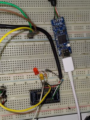

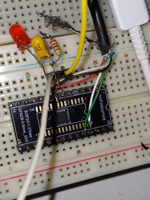

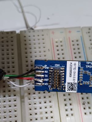

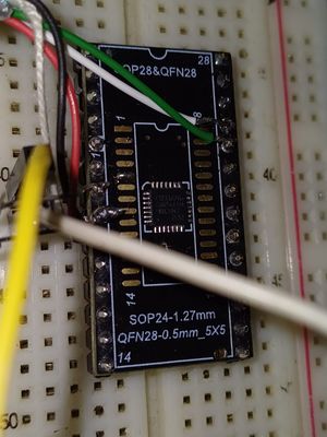

i have a stlink v3 mini and 3 stm32c031g4u6 microcontrollers soldered to proper breakout boards.

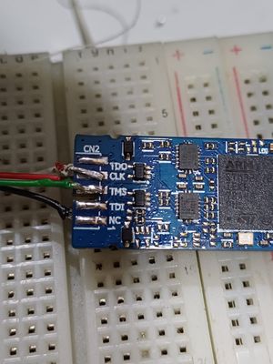

i have SWD interface soldered from the edge connector because i had no luck with cn4.
SWDIO, SWCLK and RESET are connected. i also have an led soldered to power pins to be sure its powered.
i am sure of the soldering job.
on my first post someone recommeded i solder capasitors so i did that still no result.
i am using linux mint's latest and the code i am trying to upload is just empty machine generated code
here are the pics:

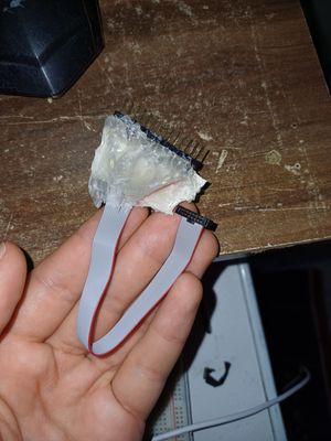

i made a breakout for cn4:
sorry for the bad solder job
thanks for help

i have managed to narrow the issue to my stlink v3 minie. i went and bought a new stlink v2 mini and it works with cubeprogrammer with the current correct wiring. it appears that i have either fried the v3 mini or dont know how to use it. either way cubeprogrammer and V2 clone works for now

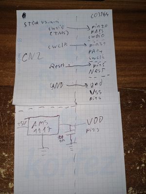

2024-01-11 11:32 AM
Perhaps a wiring diagram?

i know. 3.3V is coming from ams1117.
here is the wiring diagram. i drew it quickly
if you wait a bit i can draw it in kicad but i have to install it

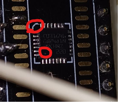

2024-01-11 11:51 AM - edited 2024-01-11 11:52 AM
Part is oriented wrong based on the footprint. Pin 1 marking on the chip doesn't match pin 1 marking on the board.
2024-01-11 11:54 AM
that is pin one not the one next to it
2024-01-11 11:55 AM
hold on
2024-01-11 11:56 AM
so pin one starts from the dot not the writing. give me a minute

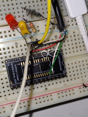

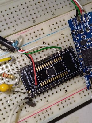

2024-01-11 12:14 PM
okay i updated the wiring but still nothing. i checked with my multimeters buzzer and everything should be good. no sign of life
green is SWDIO and its connected to TMS on cn2
white is SWCLK and its connected to CLK
any ideas?
2024-01-11 12:43 PM
i know i am being annoying but please help. i fixed the wiring but there is still nothing. reset pin is high, SWDIO and SWCLK is low
for a moment i got an error for something about usb connection but now its back to same error
thanks for all of your help
