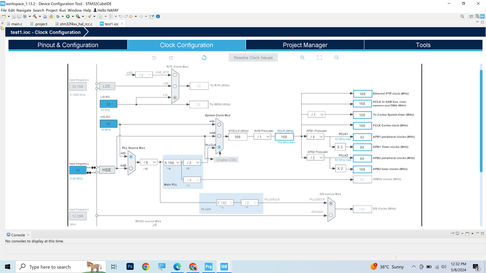

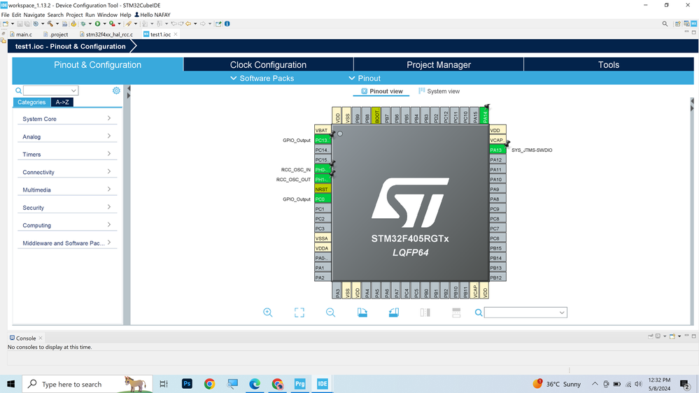

let me show you each step i did there any suggestion will be beneficial for me from you side:
Firstly i enable some pins one gpio to get a output, swdio , swclk, 2 pins for oscillator and set the clock setting
After that i write a small code as an exampke in the existing main.c to check weather my stm32 is uploading a code correctly or not .
