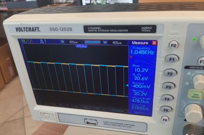

2024-05-09 3:11 AM - edited 2024-05-09 3:12 AM
This is how the waveform looks like when I change frequency after calling positive Quadrature function (the frequency becomes half as well)
2024-05-09 3:29 AM
Fixed by setting the mode to the previous one (PWM1) when the frequency function get called.
