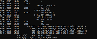

Bin file snippet of STL project for Nucleo – L476:
Bin file size is 393MB, this is huge, we can’t bootload this file using Bootloader App. It should be in KBs.

The commas also look very oddly placed. Show a DIR from a DOS Box or File Manager
Large .BIN files typically occur due to large discontinuous sections in a .ELF file, or .HEX
BIN files can't have VOIDS in them, and must describe all space between the beginning and ending addresses.
Inspect the .ELF with tools like OBJCOPY, OBJDUMP, FROMELF, etc, you're likely outputting data into RAM spaces or EXTERNAL MEMORY, which wouldn't be appropriate to be in the .BIN
2025-01-29 10:53 PM
Hello Tesla,
Please see below snippet for debug DIR
