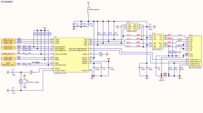

make sure you have the correct pins assigned to Ethernet maybe check the schematics for the default solder bridge configuration :
