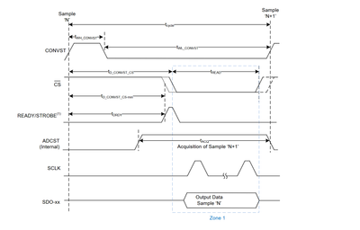

This is a precision ADC, so whenever conversion is finished , the chip will raise a ready signal which for a few nanoseconds, when that happens i need to pull the cs low, for about 284ns, then i need to pull it backup before next cycle happens. A full cycle is about 600ns.

That alone won't do it, but I'm currently trying to make that part work.
This is the timing diagram for the ADC

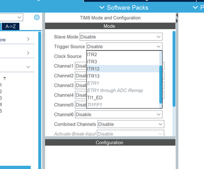

What would be the best way to trigger the timer when the GPIO connected to ready pin changes, with less delay.
What is ETR, I know the ITR is for master timer to trigger slave timer?

Normally, one uses timer output to start the conversion, then, after the result is ready, it should be read using SPI. Conversion time + reading time must be >= conversion cycle time.
It's you who decides on starting the conversion and on conversion frequency, not the ADC.
2025-10-27 10:38 AM
I would set up a pin as EXTI to trigger a write to SPI when the ready pin goes high. Add DMA to read out the content of the SPI. Let SPI control the CS pin. It will pull it down, do the transaction, then set it high again.

The original description sounds to me as a single-shot, i.e. I'd use TIMx_CH1 (or TIMx_CH2) as Input (technically set to Capture) to the Slave-mode controller, set TIMx_SMCR.TS to respective TIxFPx, set TIMx_SMCR.SMS to Trigger, set One-Puse mode i.e. TIMx_CR1.OPM=1, set one of the remaining channels to Output Compare/PWM, and set its Fast Enable bit (TIMx_CCMRx.OCxFE=1). That would generate the complete pulse, but that won't start SPI.
If SPI would need to be started, I'd probably try something along DMA triggered by TIMx_DIER.TDE transferring some dummy data to SPI_TXD to start read transfer, but the 'H7 SPI is exorbitantly complex and I don't know its ins and outs, I don't use 'H7.
In other words, I believe this could be automated to run entirely in hardware; but details have to be worked out, based on deep enough knowledge of the chip. This may be clickable in CubeMX, if one knows where to click... but maybe not. I'm not a Cube user.
