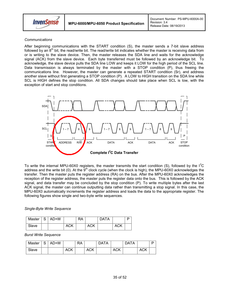

I am using an STM32F411, and am attempting to use I2C to communicate with an MPU-6050 (relevant datasheet info attached).

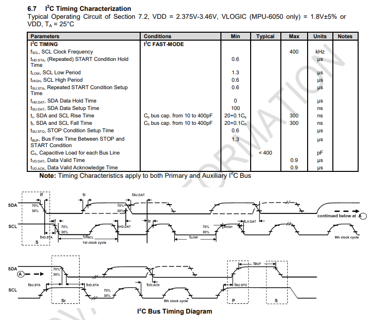

I've tried to setup I2C in accordance with the timing requirements on the MPU-6050 datasheet:
