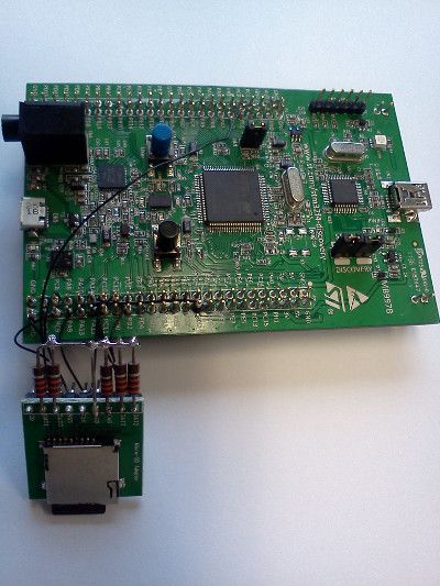

You could download a merge tool like WinMerge and observe the changes between the prior release and this. I'd say not that much, just small stuff that was critical. In debugging it became apparent that my hard faults were coming from indirect accesses through memory that the FsFat software assumed were zero. I confirmed what the run time code was clearing, and then tried to understand why. I gleaned most of the information from the MAP file produced by the linker. I also wire-wrapped up a breakout board that I picked up on eBay via Hong Kong so I could finally test on the STM32F4-Discovery instead of the custom board that already has a working MicroSD socket on the PCB. It's hard for me to judge the simplicity/complexity of all this, I've got pushing three decades of micro processor/controller experience, built several wire-wrapped computer systems and boards as a teen, and have a pretty deep involvement in compilers, linkers and loaders.We’re moving the ST Community to a new platform to give you a better and more reliable community experience.
