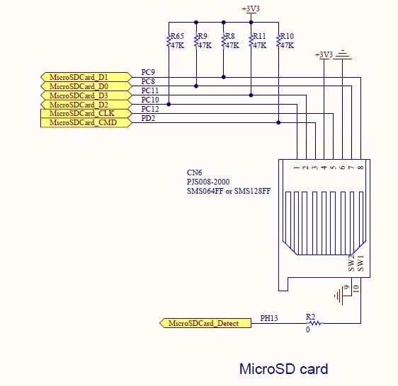

You need pull up resistors on the pins, review a schematic for the STM3240G, or other, eval boards.

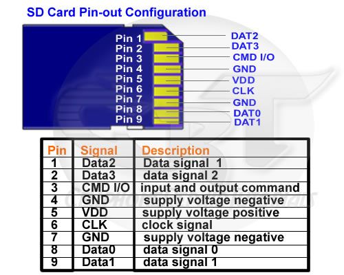

When searching the internet and looking at my sd card i count 9 connections.
should i use the connections as in the schematic below. Can i say that when i can read the size of the sd card the connections are right. i only need to put the pull up resistors. Which i'm going to do tonight, after these pullups it should work.2012-07-04 5:32 AM
The rest of us are using MicroSD form factor cards.
The pin numbering on your picture is wrong. Seehttp://en.wikipedia.org/wiki/Secure_Digital
You will need to pay attention to the pin configuration of your specific socket. SD SOCKET Naming and Connection COM - COMMON - GND WP - WRITE PROTECT - GPIO Optional CD - CARD DETECT - GPIO - PC2 or whatever, external Pull-Up Optional use internal P9 - DAT2 - PC10 47K PU IRQ - DAT1 - PC9 47K PU D0 - DAT0 - PC8 47K PU GND CLK - CLK - PC12 VCC - 3V DI - CMD - PD2 47K PU CS - DAT3 - PC11 47K PU Generally breakout boards are easier to wire, and you can tack a resistor pack on the top side. Many have clear pin markings and function names.http://www.sparkfun.com/products/204
