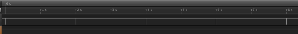

I am transmitting '@' every 2 sec as shown below without parity.
fig.1.
fig.2 expanded wave form of each byte.
Below is the wave form with even parity setting:
fig.3.
fig.4. expanded wave form of bytes with even parity
seen on desktop terminal in ascii format ''�À''
In hex format as ''C0''
