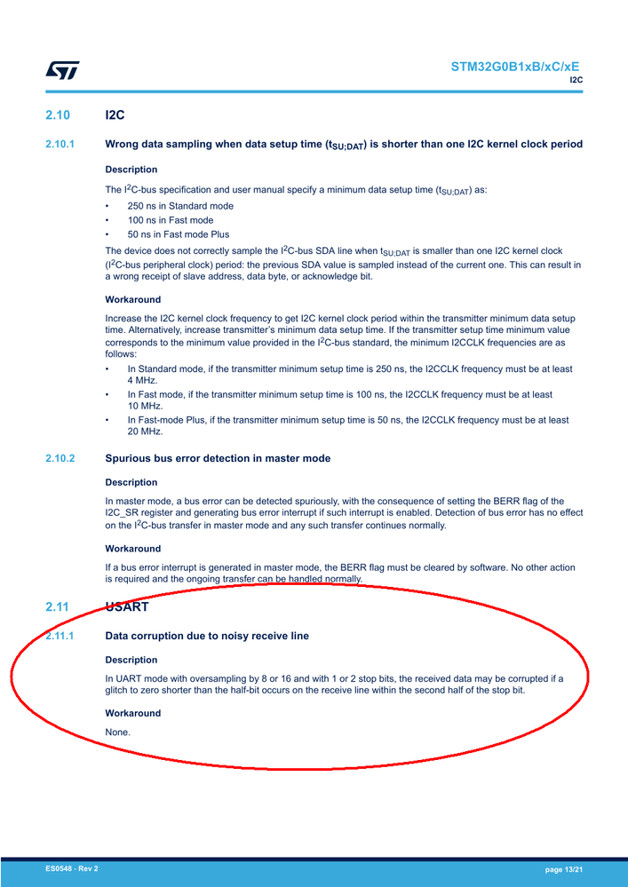

I came across a problem exactly described by this erratum:
As you can imagine, this was "fun" to investigate.
You may ask, "But Jan, don't you know you should read the Errata first?". Problem is, this is ES for 'G0B1, whereas the problem was observed on an 'L431.
Now, this erratum was already present in rev.1 of the 'G0B1 ES, of Jan.2021. The 'L431 erratum is now in rev.7, of May 2022, and its previous revision was May 2021, yet there's no mention of this erratum there.

That this erratum affects UARTs of STM32s starting from 'F0/F3, was confirmed experimentally on a 'F030 Nucleo.
So, ST, please maintain Errata, and also this.
