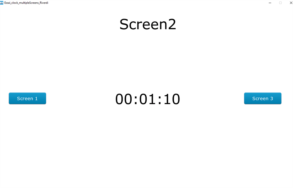

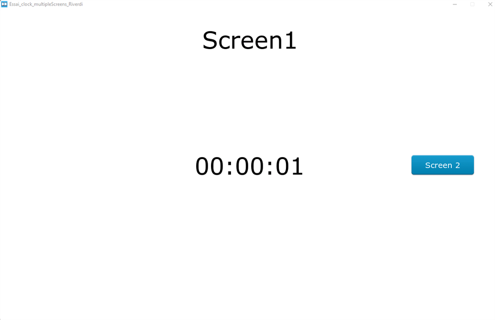

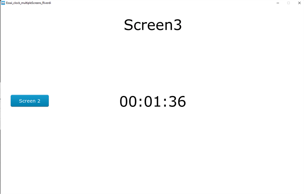

2022-07-26 6:30 AM
Hello @Yoann KLEIN ,
Sure, here's some screencaps of the simulator.
Yes the propagation works fine, it's the clock I set that has a problem. I set with my fakehardware the clock to 08:25:36 in screen1.
It stays at that time for 1 second then it reverts back to 00:00:01
From there it continues counting like it should
When I change the screens it propagates well.
But that's not the time I wanted to set at the beginning. I wanted to start at 08:25:36 and start counting from there → 08:25:37 instead of 00:00:01
Kind regards,
Eve
