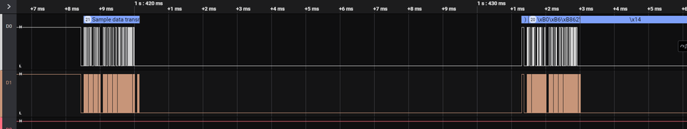

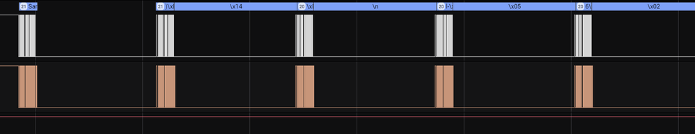

I was working on a simple SPI transmit code, I am transmitting some string data via SPI Half duplex, the code is like I press blue button on the discovery board, and it transmits data, which I read from logic analyzer, but every time after data is transmitted, and I keep button pressed/release and press again, it also sends some garbage values after that, and keeps on doing that, I can't figure out what's wrong, pls find Code and Analyzer traces below

I wouldn't call it buggy. It is simply not intended for precise timing required by bidir SPI.
Maybe it's better to avoid bidir (halfduplex) SPI at all, if that's an option.
2022-07-02 8:52 AM
> SPI Half duplex
If you mean extra clocks after data have been transmitted, it may be SPI being turned to Rx before disabled, in the HAL function. I don't use Cube/HAL and am not interested, you can look it up if you want, Cube/HAL is open source.
2022-07-02 1:26 PM
If i remember correctly, HAL_SPI_Transmit disable SPI after transmission. SPI output lines become HiZ. Logic analyzer can't reand HiZ lines correctly and can't be trusted. If you need, check output by oscilloscope to confirm that. If you need, you can equip your SPI lines by pullup/pulldown (you can use embedded resistor on MCU), or you can throw away HAL and manage SPI transfer by LL API or by direct register acces. If your slave device have CS pin, then you probably have no problem with that (nobody don't care about SCK and MISO if not addresed by CS).

2022-07-03 8:07 AM
