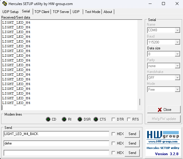

According to CM7 core, LED_M7 (PI12 connected) is blinking individual from UART Transmit (Interrupt method). UART Transmit IT function (also callback function works good too) works successfully. I can check sent data by Hercules.
