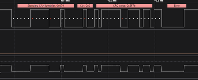

The issue I am running into now is when I try to connect my STLink V3SET to the STM32L431 over CAN using STM32CUBEProgrammer. When I hit connect, the program sends over CAN STD ID 0x79 with no data. My code will send back the STD ID (0x79) with a NACK(0x1F) indicating that the command doesn't exist. STM32CubeProgrammer then gives me a BRG_BL_NACK_ERR and I am unable to continue.
After looking at the documentation, code, and example code, I am unable to find the opcode/command 0x79 anywhere. So, I am confused as to why STM32CUBEProgrammer sends that command. I see that 0x79 is supposed to be an ACK but that is it. It shouldn't be sent as the STD ID/command/opcode. Please let me know what I am missing here.
CAN TX LINE:
I am using a PEAK PCAN to sniff the bus. I am using C_TX(pin 9) and C_RX(pin 8 ) on the stlink v3set to connect to a CAN transceiver (https://www.adafruit.com/product/5708)
