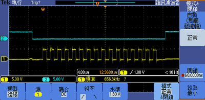

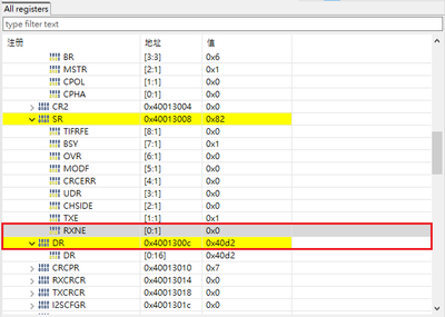

When I use a slower SPI frequency, both the timing and the data are correct.
If SPI Config hspi1.Init.BaudRatePrescaler = SPI_BAUDRATEPRESCALER_128:

RXNE Reset & DR Data is Correct
Blue is CS, Yellow is SCK

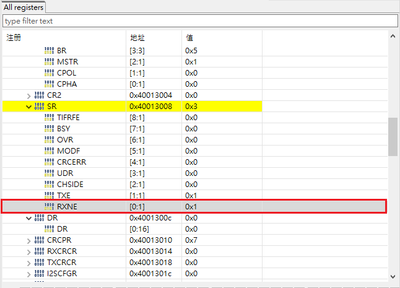

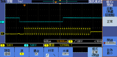

However, when I set the SPI frequency to be faster, errors occur.
If SPI Config hspi1.Init.BaudRatePrescaler = SPI_BAUDRATEPRESCALER_64:

RXNE no Reset
