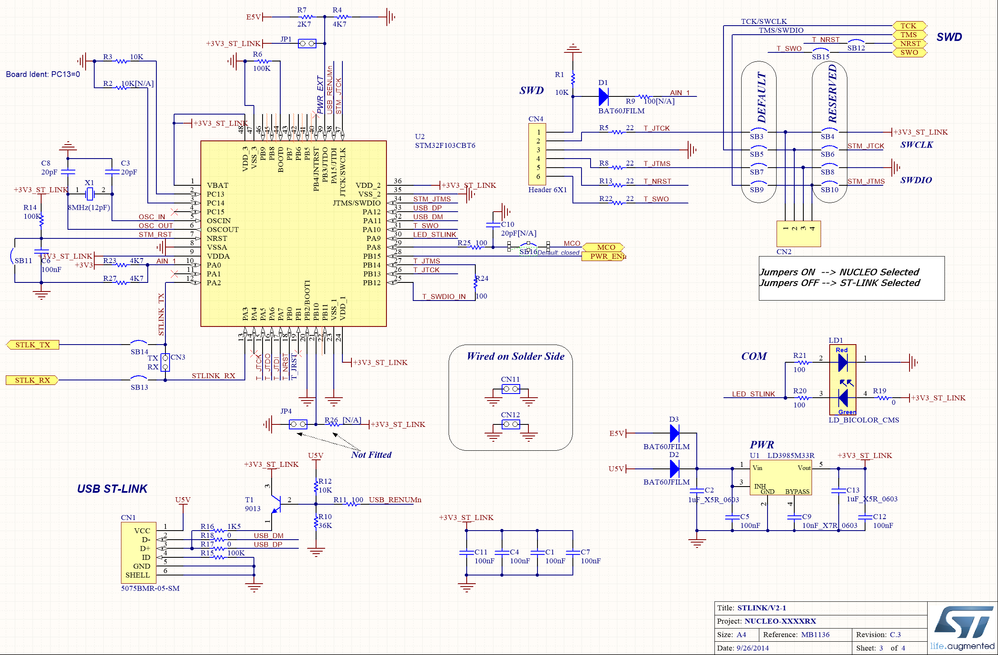

Yes, you are right. I couldn't find the ST-LINK schematic but if we assume that is same as NUCLEO ST-LINK, the SW pins are connected to 5 V tolerant pins which the Vih is 1.615 V.
2017-06-26 2:32 PM
The DISCO/NUCLEO schematic really doesn't shed much light on the stand-alone implementation.
PA4, 5, 6 and 7, and PB0, 1 are not 5V tolerant.
2017-06-26 11:51 PM
You are right. JTAG pins are not FT but SW pins (SWDIO & SWCLK) are FT pins and it seems that there is no big problem to use them. However, as you said, we cannot assume with certainty that the DISCO/NUCLEO schematics are same as stand-alone implementation.

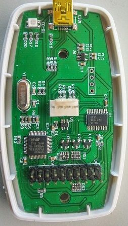

Below is a cloned version from China (hey, it just somehow appeared on my desk!)
TI's voltage translator is sitting there.
However....(using above designators )
I made some short test and discover that
SWCLK and SWDIO pins(pin7 & pin9 respectively) are directly connected to
the STM32F103's pin 26 27 throuth 100 ohm resistors(RS1) and with a protection diodes (U2).
But SWDIO also connects to Voltage translator's B3 port, and A3 port connects to STM32F103's Pin25(PB12)
As for the TI's voltage translator, OE and DIR pins are both grounded!

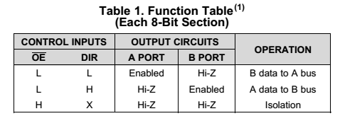

Checked the datasheet, it says.
(A should be the 3.3V side and B for target Vcc)
I think, as least for this cloned version,
the level shifter just works for SWDIO from Vcc target side to Vcc st-link side.
