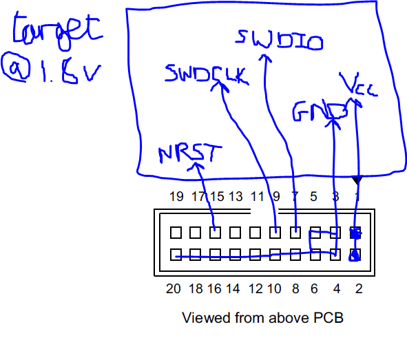

Apologies for crudity of diagram!
Yes it is a genuine brand new ST-link v2.
The target board has its own LiPo and regulator providing a Vcc of 1.8v. This is connected to pin 1 and 2 on the ST-Link as per the pinout diagram for SWD in UM1075.
If I just connect GND and Vcc then Vcc remains at 1.8v, but testing SWDIO and SWCLK they are both at 3.3v.
I expected the target voltage to vbe used to drive the other outputs as you say, but they don't seem to do that...?

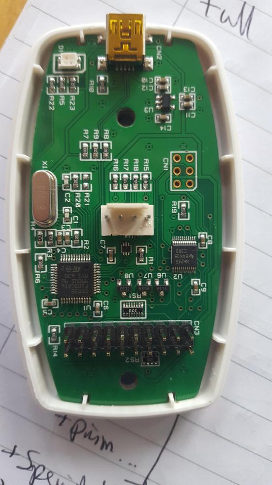

Mine is from Farnell and has U2 in place and does not look like a clone either.
A simple stand-alone test I did was to put 1.8v between Vcc (pins 1&2) and GND (pins 3,4,5,6,8,10,12,14,16,18,20) and then have a look at SWDIO (pin 7) and SWCLK (pin 9). On my system both are at 3.3V. We really need a schematic or some good inside knowledge of what's going on.

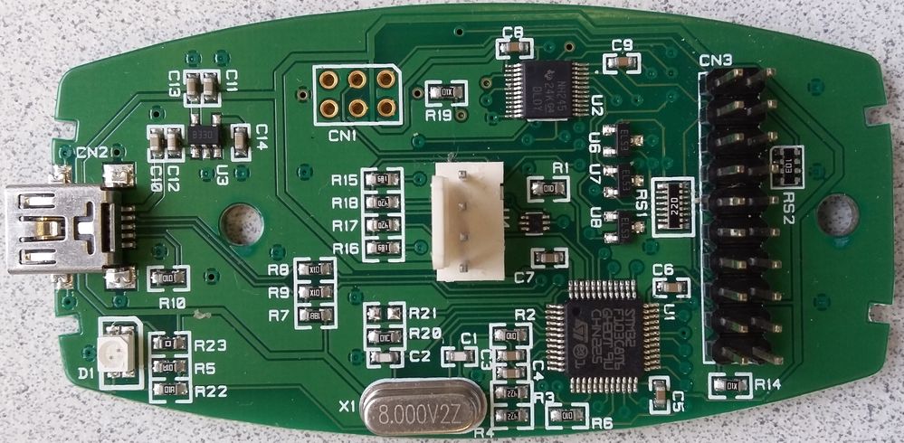

The clones don't have the level/buffer chip (245)
https://wiki.cuvoodoo.info/doku.php?id=jtag
This is what an official one looks like inside, U2 is the buffer chip

For my adapter, purchased from Digikey, it looks like an authentic device per your U2 level shifter reference; same TI product package marking. Trace layout and the ground pours also look spot on, doesn't seem like a clone.
Any other thoughts?

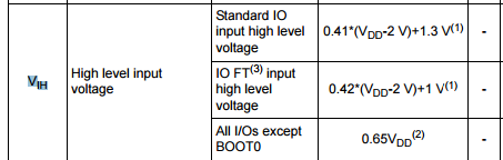

Looking at controller datasheet (STM32F103), Vih is the following.
If VDD is 3.3V + 5% (example accuracy tolerance of supply), then standard IO pin is 1.900V Vih. If SWO/CLK go to 5V tolerant pins on STLink, then 1.615V Vih. I didn't see an STLink schematic, so can't check the mapping. So depending on which pins this maps to, this might be more of a problem when talking with 1.8V target. The concern here is corner cases, especially with disparity caused by unexpected connector impedance or ground levels.
