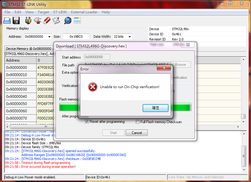

Use the Cube Programmer, the ST-LINK Utility v4.2.0 is very flaky with external memory, and not the active development path.

Then why the marketing status is Active?
2018-05-11 1:40 AM
It works for the most part. I'm saying from observation that development effort has forked, the branch that has development resources behind it is the Cube Programmer, moving forward migrate to that.

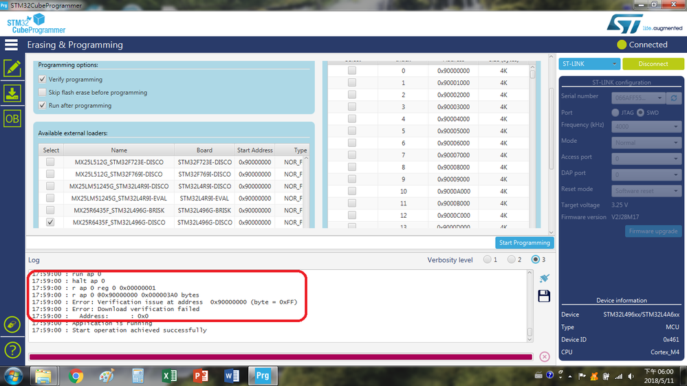

Cube Programmer got same problem.
