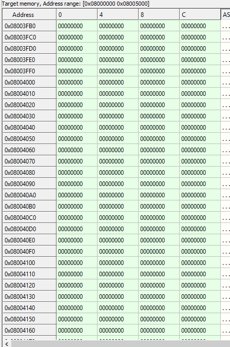

Hello all,
I used the stm32 st-link utility tool to analyse the flash and set the , ♯ define APPLICATION_ADDRESS to , , (uint32_t)0x08004000. I put a call of the erase funktion at the beginning auf the download image funktion, so that the flash gets resetet before I upload the image.
void SerialDownload(void),
, FLASH_If_Erase(((uint32_t)0x08004000)),Here is a screenshot of the rigster values after I send a ''1'' for download image and before I send it via ymodem.

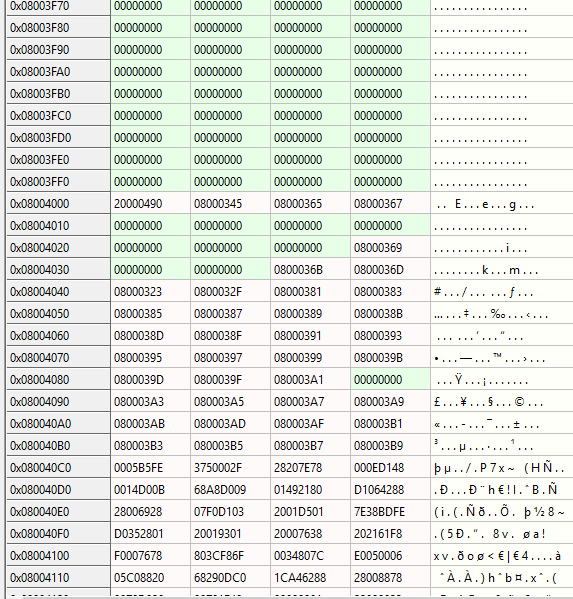

As you can see, all registers are cleared. Then I loaded the .bin file via ymodem und analysed the registers again:
As you can see, uploading of the image works and the code beginns at 0x08004000. The .bin file consist a small projekt were I toggle the led. But it doesnt work when I press ''3'' for execute the loaded application. I looked in the menu.c and this is the code which runs by pressing 3:

2018-05-14 10:52 AM
The image you show here is for code that was clearly NOT linked for an 0x08004000 basis (see linker script, scatter file, ie .LD, .SCT, or .ICP)
The ResetHander is marked as being at 0x08000345 which is below the 0x08004000 threshold.
2018-05-15 1:30 AM
Hello Clive One,
you are right. I had to change the __ICFEDIT_intvec_start__ = 0x08004000; in the .icf and now everything works. Thank you really much for your support.
