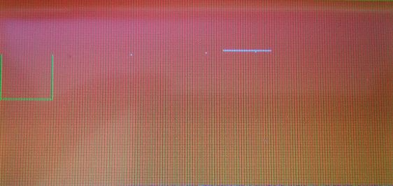

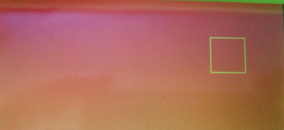

I am also having a possible similar / related problem. For testing I'm drawing a square onto a plain background in a frame buffer, then transferring the buffer to the screen though the FMC (not using dma). If the colour of the square is white, then the SSD1963 chip stops listening to the transfer partway though the update as show here:

Managed to get a little more time to play around today. Heres what I've found out. I suspect the pull-up is a bit of a red-herring. I'm guessing its just skewing a clock edge a little.
With the AHB bus at 42MHz (pll-p=/2, AHB=/4, APB1=/2, APB2=/1) I can use Data-Setup-time=4 on the FMC controller and the SSD will update correctly. Using this setting I can get 29 full screen updates per second (320x240), this is good! When I move to a faster speed where the AHB bus is at 84MHz (AHB=/2) then I can only get the SSD to respond by setting data-setup-time to 160 for the FMC. This works, but the update rate becomes very slow and I can only get 7 full screen updates per second. If I set the Data-setup-time any lower, either the display doesn't respond or or corrupts with bad data. I assume its something to do with the 1HCLK cycle after the write pulse (pg 1601 of the reference manual) being too fast for the SSD. The max command rate for the SSD is half the clock. I have my SSD clock set to 120MHz which give a maximum speed of 60MHz, hence why 42MHz works and 84Mhz doesn't. It seems a shame to have to run the AHB at 42MHz to get this working, there must be a better way to adjust the timings on the FMC that I'm just not seeing. Edit: This is running from a frame buffer in the INTERNAL SDRAM. If I switch to the EXTERNAL SDRAM, I once again get corruption caused by various colours (primarily white). Might have to stick with internal frame buffer for the time being, fortunately I can do this with the 320x240 screen.We’re moving the ST Community to a new platform to give you a better and more reliable community experience.
