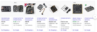

@ose7b wrote:the "Black" STM32F407VET6 board,
anyone can make a black board!
Is it one of these:
please give a link to the one you're actually using.
