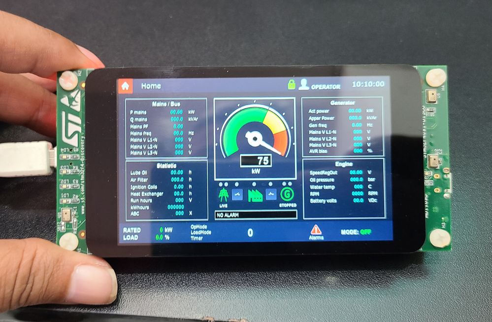

Hi @PSEBA.1
why you not directly interface LTDC instead of FSMC ?
LTDC provides direct and flexible support of TouchGFX.
I did lot of developments across STM32H7 and TouchGFX with LTDC.
also I worked with TouchGFX with STM32F429 ...
