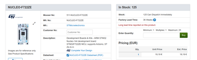

so why not:
..in 3 days you have it. :)
+ in 5 weeks..
2023-12-12 1:15 PM
I don't get it ? 767 is in your image 17 weeks factory lead time (and those 17 weeks is there for months, they do not have them planned at all, they are just out of stock and no idea when will be available) ... where do you see 3 days? you trust that "expected" :D ... mouser have them on order for years and is expecting them "in few weeks", comet too, avnet too, farnell too... but if you go directly to ST they are not making them ... we had bunch of those but had to use them up during chip shortage ..
yes, if you want order 500 pcs.
but -hey- i just want show you some boards, to use for your test. very similar...but not the target. right.
and those are in stock...so 3 days. (at least here in Germany, if i order from US /mouser .)
and nucleo-F767 - no stock. right now. but Jan/24 ->
but the F767 chip, in 144 lqfp, 1600 in stock -- how many you need in 3 days ??
