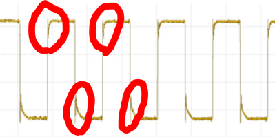

we planned to add resistors to test but when I look signals under scope I do not see any issues .. and also at 400khz at few mm I do not see htf can any ringing happen but.. after all the @#$()&^@ on this project I can believe anything at this point... wasted weeks on something that was in reality 2-3 hours of work :( all 'cause of pcb issues :(

Really can't imagine this is a PCB/interference issue at 400 kHz if the chips are 10 mm apart.
You have some weird bounce happening on the clock. Initial edge is super sharp, but then it bounces back and goes slowly to the rail. Could be a miscalibrated scope.
Also think sending a better pattern would be useful. Perhaps 0x0102, and the inverse, and post it here.

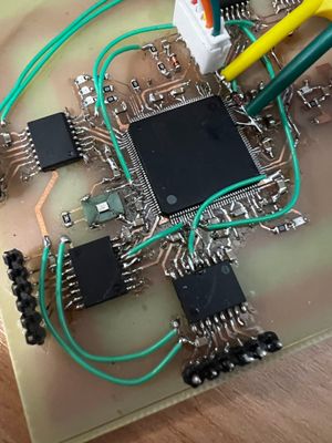

as for "can't imagine this is a PCB/interference issue at 400 kHz if the chips are 10 mm apart." ... it is hard to imagine how bad pcb can be... our post is in strike for few months so can't order anything so we made it in-house and changed whole bunch of things after the fact so now it looks... well ..

2023-12-12 8:12 AM
That looks awesome. I'm sure you guys had fun making it.
2023-12-12 9:02 AM
hahahah yeah, my type of sarcasm :D :D :D ... fun :( ... the story about this project is one of the worse in my career :( everything that could go wrong went wrong ... i started to doubt my basic knowledge about electronics with this project... but .. we'll get there :)
