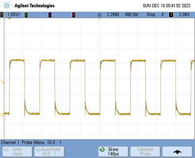

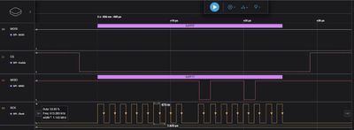

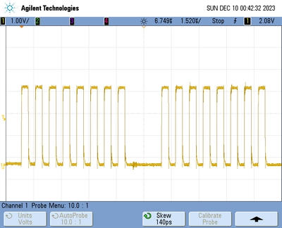

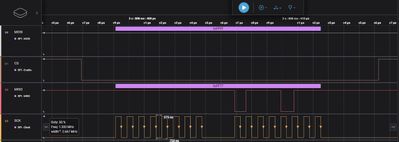

What I see is same "shape" as 0xF77F only looking at some random clock. here is from LA at two different speeds of the MASTER:
and the scope on the clock directly on MCU pin (slave mcu) looks ok, not super perfect but ok

sending F77F
looking at both 666khz and 1.2mhz I see FF77 .. so first nibble is ?!?!?! then I have ok F77 and then I'm missing a nibble .. like whole word is "nibble late" ?!
