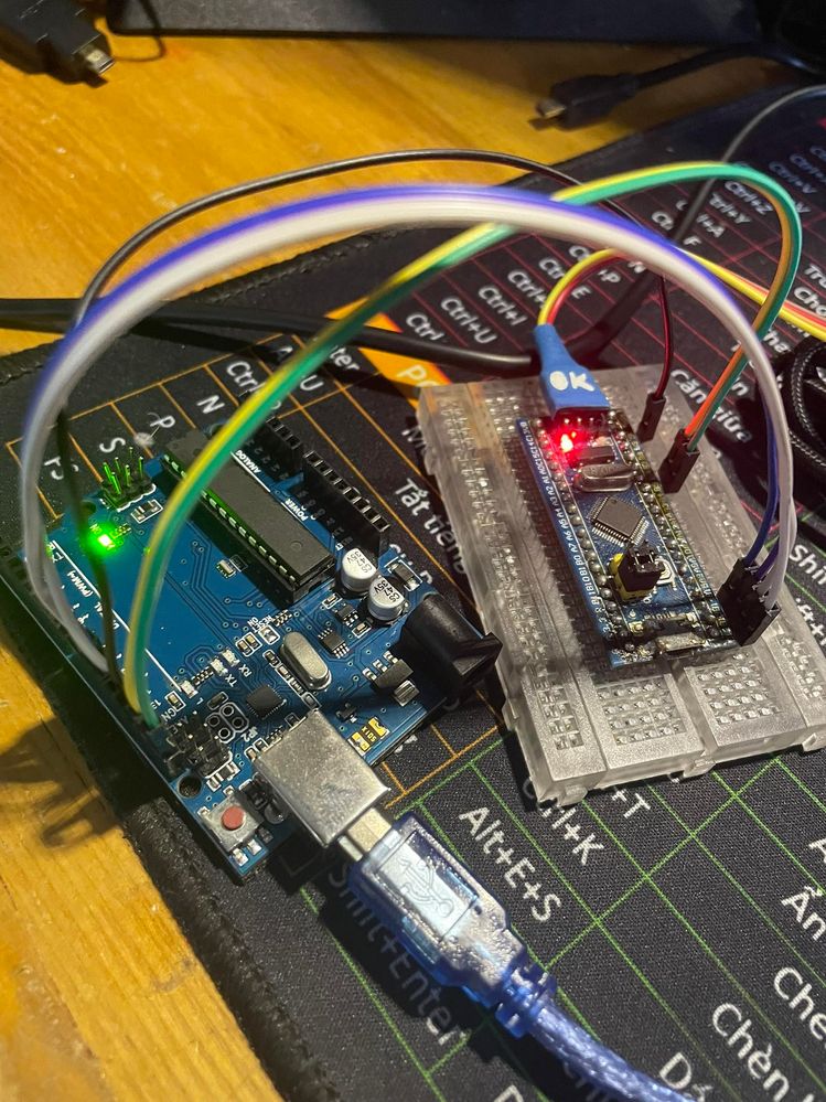

My problem is the SPI communication between the blue pill board STM32F103C8T6 (slave) and the Arduino Uno R3 board (master). Here is my setup:

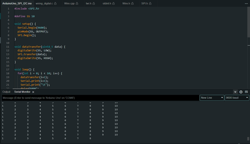

1. For arduino:
The code:
#include <SPI.h>
#define SS 10
void setup() {
Serial.begin(9600);
pinMode(SS, OUTPUT);
SPI.begin();
void dataTransfer(uint8_t data) {
digitalWrite(SS, LOW);
SPI.transfer(data);
digitalWrite(SS, HIGH);
void loop() {
for(int i = 0; i < 10; i++) {
dataTransfer(i+1);
Serial.print(i+1);
Serial.print("\t");
delay(1000);
Serial.print("\n");

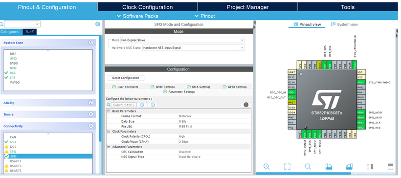

Here is my SPI2 configuration:
static void MX_SPI2_Init(void)
hspi2.Instance = SPI2;
hspi2.Init.Mode = SPI_MODE_SLAVE;
hspi2.Init.Direction = SPI_DIRECTION_2LINES;
hspi2.Init.DataSize = SPI_DATASIZE_8BIT;
hspi2.Init.CLKPolarity = SPI_POLARITY_HIGH;
hspi2.Init.CLKPhase = SPI_PHASE_2EDGE;
hspi2.Init.NSS = SPI_NSS_HARD_INPUT;
hspi2.Init.FirstBit = SPI_FIRSTBIT_MSB;
hspi2.Init.TIMode = SPI_TIMODE_DISABLE;
hspi2.Init.CRCCalculation = SPI_CRCCALCULATION_DISABLE;
hspi2.Init.CRCPolynomial = 10;
if (HAL_SPI_Init(&hspi2) != HAL_OK)
Error_Handler();
/* USER CODE BEGIN SPI2_Init 2 */
/* USER CODE END SPI2_Init 2 */

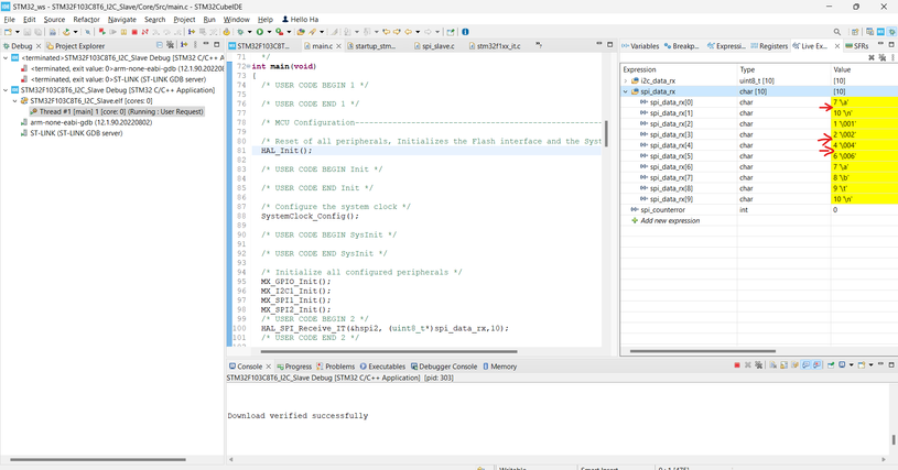

Though I send 10 numbers from Arduino, I still miss some numbers when my stm32 reads them

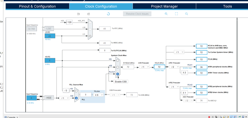

STM32 clock configuration:

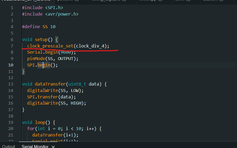

I tried lower the speed of Arduino clock about 2 or 4 times, but there is no use, the stm32 still misses the data.

Thanks, but the hardware connect doesn't matter. I connect both SPI and I2C, the I2C works okay, but the SPI is very problematic :(((
