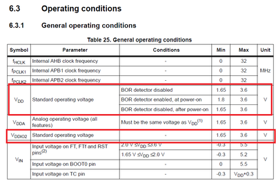

According to the datasheet:
So yes you can connect VDDIO2 to VDD.
