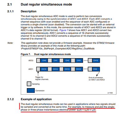

@Lupin wrote:
But that call is so slow (because it does the whole ADC initialization and deinitialization every time), that there's too much time between the voltage and current measurement.
I'm wondering why you don't use the "Dual regular simultaneous mode" described in the application note AN3116 "STM32™’s ADC modes and their applications" for your current and voltage measurement:
2026-02-11 8:09 AM
I intend to port this to an STM32L031, which has only one ADC, so I don't can't use that feature. I know that I have to watch out for the differences between families. But it's easier to develop on the slightly bigger STM32F1, where you have more flash/RAM for debug purposes.
I think I wouldn't even need DMA for my purposes. Just doing single conversions using HAL instead of Arduino would be much faster already. But hey, if I'm leaving some Arduino things behind, I might as well make it harder, so I have more chances to learn something, when something doesn't work as expected ;) .
