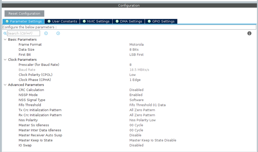

SPI master:

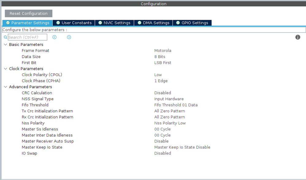

SPI slave:

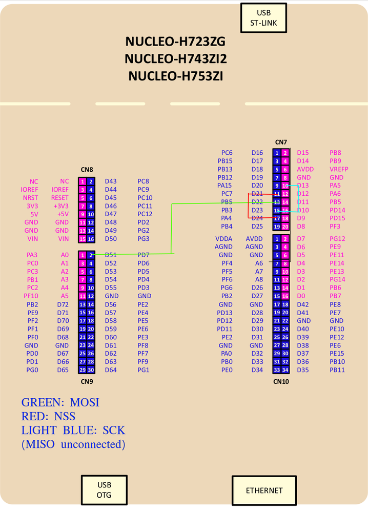

With the following pins:

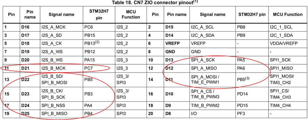

I have connected wired the pins as following, by looking at the provided table:

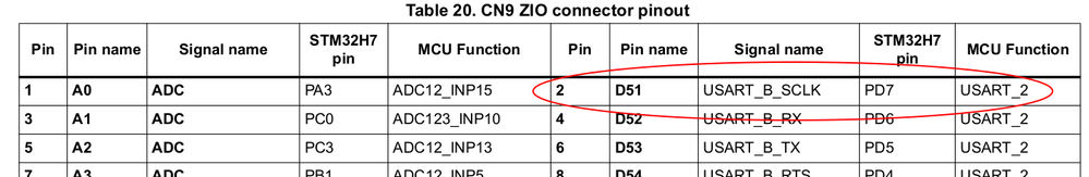

In order to have both SPI master and slave in the same board, I have needed to use PD7 for the SPI master, which is described as an USART pin in the following table, but I'm not using the USART so I can use it for SPI.

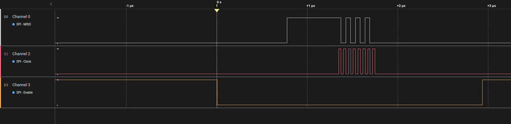

}The result I see is the yellow LED blinking, and the red one set, which means the slave reception didn't go well, I'm assuming because of a timeout. Also, I'm able to see the master SPI transactions in my logic analyzer:
What I'm expecting to happen is that the master sends the data to the slave, the slave receives it and puts it in its RxFIFO, and then (after the master finishes) I can read it.

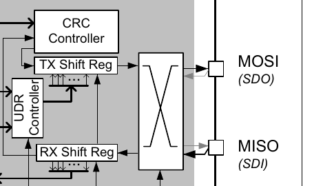

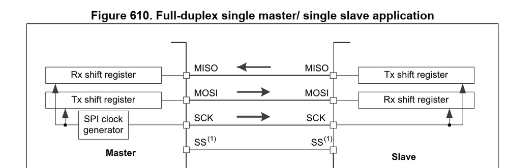

2023-03-03 4:58 AM
read in rm : is in/out swapped in slave mode ?
or just try: set "IO Swap " -> enabled . on slave device, then try again.
2023-03-03 5:06 AM
Do you mean like in a UART, that source and destination need to 'swap' Rx/Tx? In SPI, MISO is MISO in both sides and the same for MOSI, isn't it?
Anyway, I tried IO Swap and it didn't work.
2023-03-03 6:09 AM
no, not both sides. only the slave device needs io swap set.
because: when setting spi-> master to -> slave, the i/o pins are swapped ! so you need to set io swap -> enabled to get them "back" to the position as in master state.
see in rm :
so : when using slave mode , you need to change miso/mosi pins or select IO swap enable on this slave device (not on the master ! ).
++ or you connect it this way: miso-miso , mosi-mosi.
